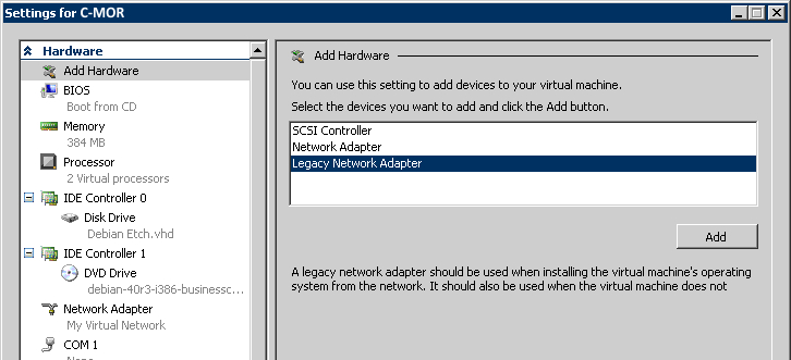

Yes, there is a special setting which may solve your problem. Simply add the
Legacy Network Adapter
to your C-MOR Virtual Machine in HyperV.
Legacy Network Adapter for HyperV
Please let us know it this solved the problem!
Michael
