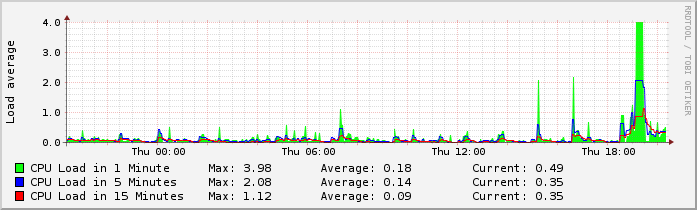

My C-MOR surveillance system runs on a Mac Mini. When I connect to the start screen the fan starts to blow and the load graphic looks like this:
C-MOR high load
C-MOR high load
Is this normal?
Frank
Re: Performance Issue
This looks like the Video View Mode "Script Stream" is used! Change it to "MJPEG" and see if the load goes up, too.
This can be set by user in the System Administration in the user settings permanently. The load should go down in Java or MJPEG Mode.
