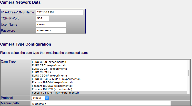

I can't get my Foscam C2 camera recording working with C-MOR.
I used the settings of the C1 Camera:
IP camera stream recording Foscam
What is wrong?
Re: Foscam C2 not working
The default TCP-Port for RTSP is Port 88.
It should work if you simply change the TCP-IP-Port from 554 to 88.
