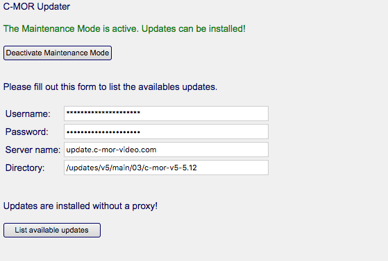

The update looks like this:

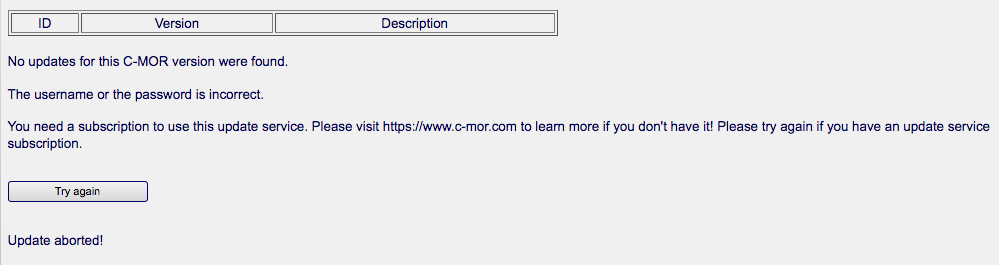

and then I get this error page:

You first need to install the camera licenses.
Obviously the upgrade to 6 cameras has not been installed yet. The path shows a 3 cams version:
The automatically selected path
/updates/v5/main/03/c-mor-v5-5.12
should be looking like this:
/updates/v5/main/06/c-mor-v5-5.12
Please install the camera licenses of your Video Surveillance and then try again.
