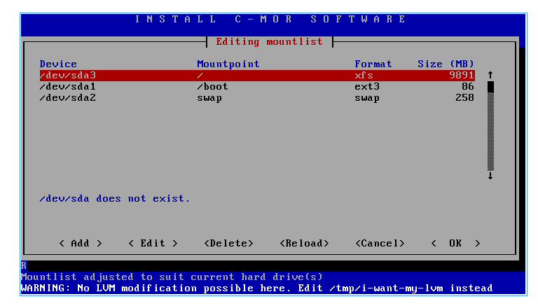

I am attempting to install C-MOR server into Xen. I am running into an issue with mounts.
First, I created my instance by selecting my CPU, memory and storage resources and selecting "other installation media" as my install option.
I select the ISO and my instance boots to the C-MOR installation menu. I select "automatic" but then the installation halts because of mounting issues.
I am getting "/dev/sda does not exist". I switch to interactive mode where I have 3 devices in my mount list.
/dev/sda3 - / (9891M)
/dev/sda2 - /boot (86M)
/dev/sda1 - swap (256M)
There is a warning message that no LVM modification is possible and that I should edit /tmp/i-want-my-lvm but that file does exist and I don't know what it is I should put in there. Furthermore, since this only seems to boot off the ISO, I don't know if adding the file will do anything.
I've tried renaming my volumes, in particular sda3 to sda, with no success. I've tried deleting all 3 partitions and building one new one with no success.
I'm a little lost. Any direction or advice on installation would be much appreciated. Thanks!

Can you provide a screenshot from the screen where you installation fails?
I just tried the installation on a Xen-Server 5 and it just finished the installation without any issues. I used the settings you described. I did the automatic installation.
Which Xen version are you using?
Which version of C-MOR are you trying to install?
Michael

Hi Michael,
I am using Xen Center 6.2 - Build 1377. I am attempting to install c-mor-v4-11pl07 (the most recent ISO from the website).
cmor-xen-6.2 install screen.PNG (13.23 KiB) Viewed 2807155 times
I think the issue I am encountering is simply that the installation doesn't seem to recognize my storage. However, when the instance boots, it is identifying the disk space I've allocated, so I am unsure why the installation process doesn't see it.
Xen shows the storage path as /dev/hda, not /dev/sda. Could that be the issue?
Thank you for helping me with this.
James

Hi,
I also used the "other installation media" for the installation.
If sda is missing usually the virtual drive is mapped as hda instead of sda. Changing this in interactive mode works, but is extensive to configure.
We look forward to do a test installation on a current Xenserver 6 shortly to track down this installation issues.
Michael

It appears to me that this is the case. I have attempted to remap this through interactive mode, but just changing the drive mappings from /dev/sda to /dev/hda has not made a difference.
You mention this is extensive; is there more to it than changing the drive mappings?

We could track down this problem.
The installation does not work in new XenServers (6.2) since new XenServer do not use the old QEMU devices any more.
Michael

We generated an image which works in Automatic Installation mode on Xenserver 6.2.
Here is the download link:
http://www.c-mor.com/free-vm/download/c ... ce-xen.zip
Please feel free and try it!

The new image worked very well. I am now running the 3 license demo server, thank you again!
