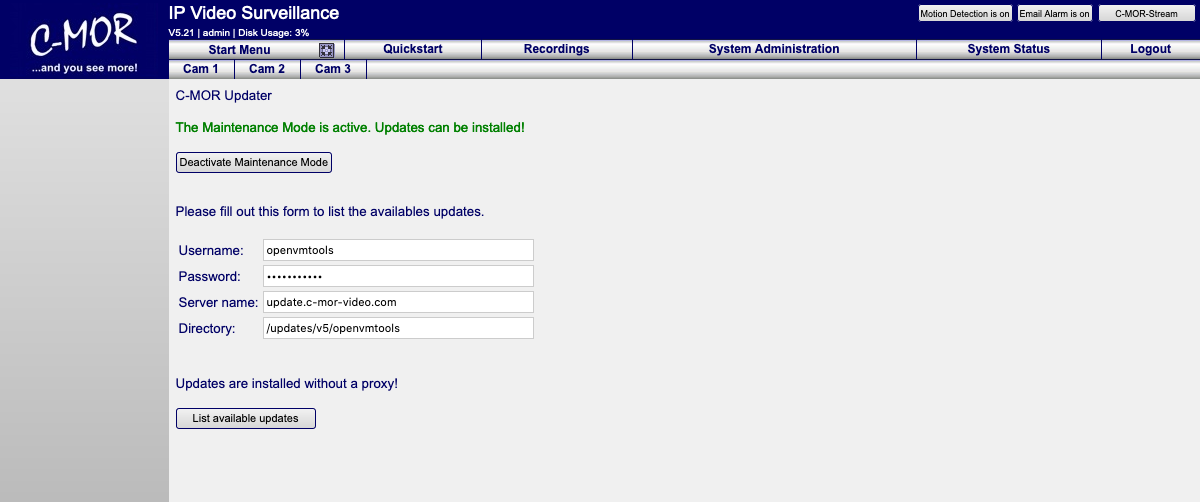

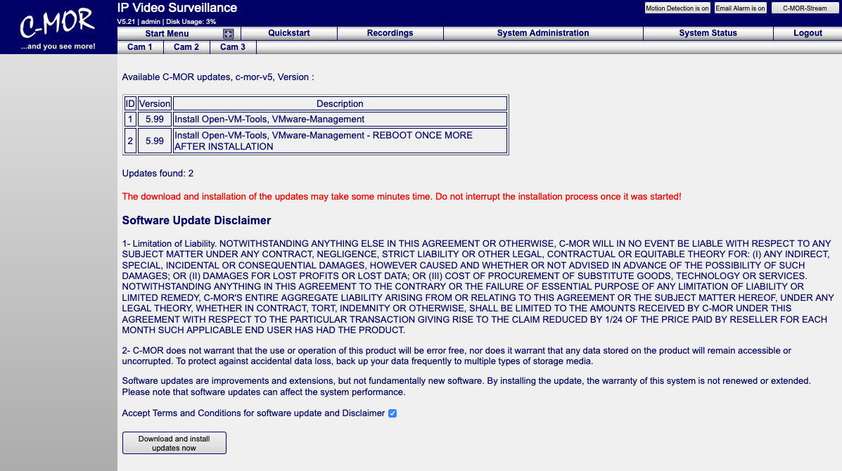

Go to the System Administration -> Software Update -> Software Update and enter the update info for the Open VM Tools. Leave the update host unchanged, use "openvmtools" as user name and pasword, use the path /update/v5/opvenvmtools to install the upates:
Open VM Tools installation Video Surveillance C-MOR.
Open VM Tools installation Video Surveillance C-MOR  list files.
