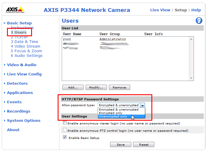

This post includes important infos regarding Axis IP cameras. Some users may have made the experience that they could not record Axis Cameras with C-MOR even the camera is listed in the supported devices list.
Axis has added a "Password encryption" to their camera firmware. This encryption is not compatible with C-MOR. It is required to swith it of, if the camera recording does not work. Please see in this screen shot which parameters needs to be set:
