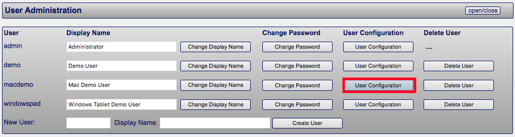

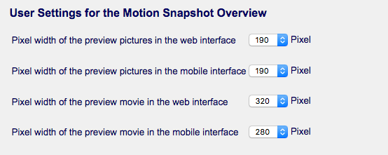

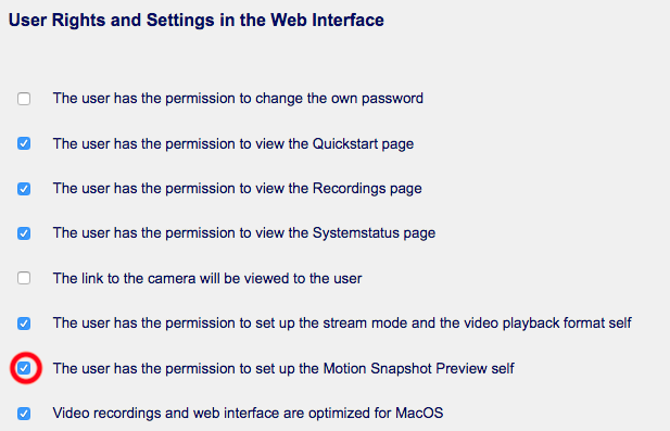

The C-MOR NVR Software got a new user management interface with version 5.10. If a user is added after the upgrade or installation of version 5.10 the rights to manage the settings by the user are added automatically. If C-MOR was updated from a version before 5.10 to 5.10 or higher the rights to manage the motion preview settings must be configured by the admin.
The following screenshots illustrate the settings:
As user admin:
As user configured for change Motion Snapshot Settings (logged in as user in System Administration page:
